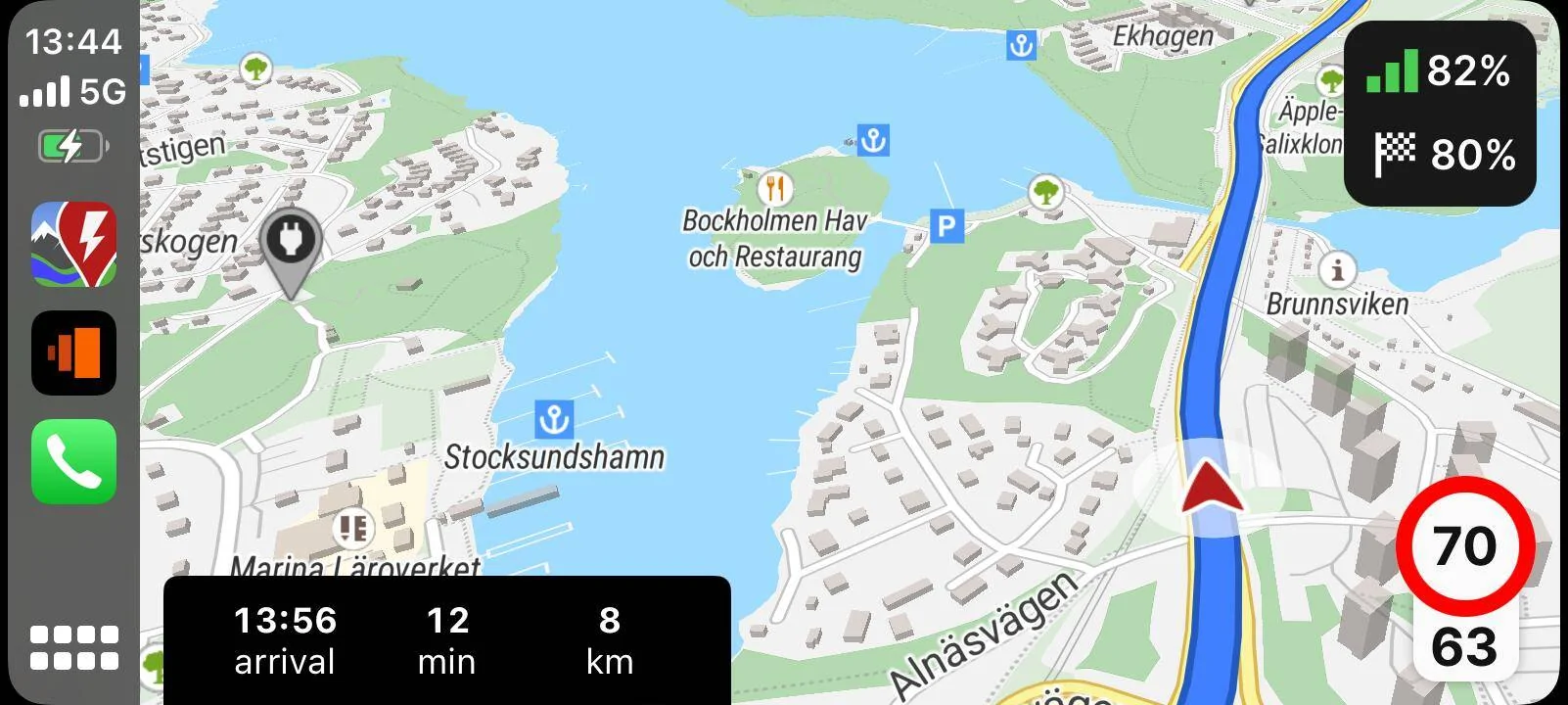

ABRP has always been great for planning since you can set strict filters. And it works excellent with CarPlay! Choosing Ionity only and stations with minimum 4 or 6 stations was great. And ABRP now utilises the connection to Porsche to give you the battery SoC with perhaps a minutes delay, but very accurate. It also will display the charging stop SoC based on information of the car’s actual consumption. I found this to be as accurate as the PCM estimates. But with out the constant irritating Map updates and replanning!
Porsche Taycan Reflections on a recent rip from Nice, France, to Stockholm, Sweden IMG_1085
Overall this worked very well and I preferred to use it.
There Are however some features that will not be as good as the PCM navigation.
1. No automatic preheating of battery when navigating to a charging station. Can be overcome to certain degree by using SportPlus driving.
2. No navigation in instrument display middle tube.
3. Since it does not utilise the car’s dead reckoning system when navigating, driving in longer tunnel systems, can give some interesting placement of car on the map!

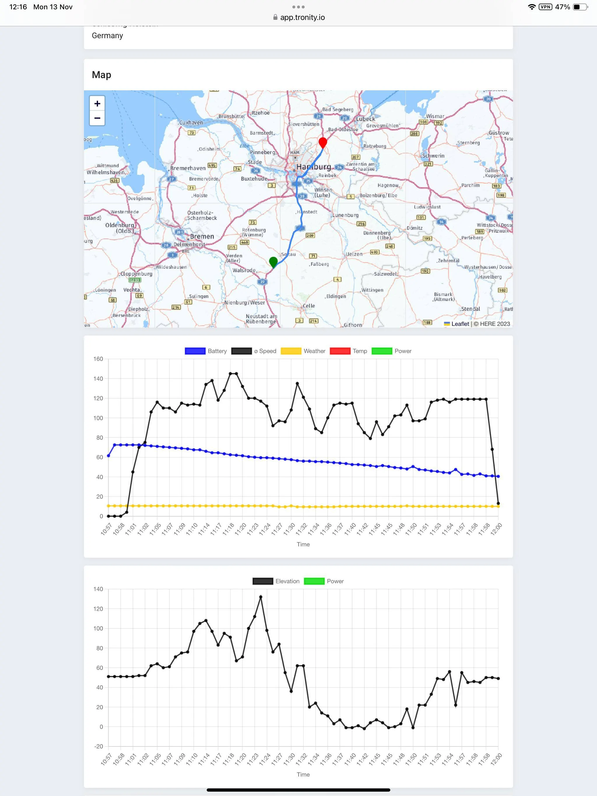

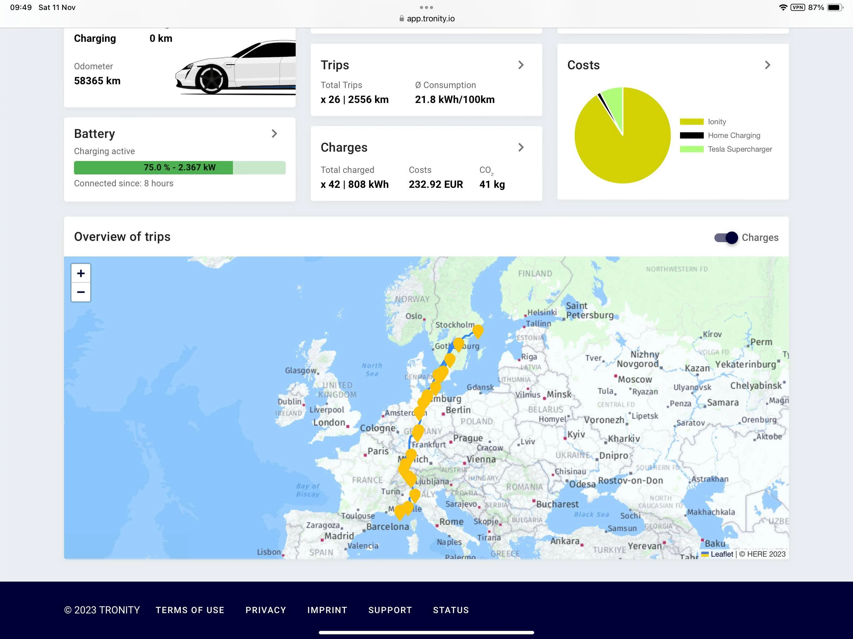

Tronity
Tronity was a new experience for me, and I was impressed. It documented our trip quite well. Except issues when the car lost data connections as mentioned earlier.
There was a lot of information navailable. It gave me the driving routes, with information about speed, altitude, temperature with both data and also graphic form

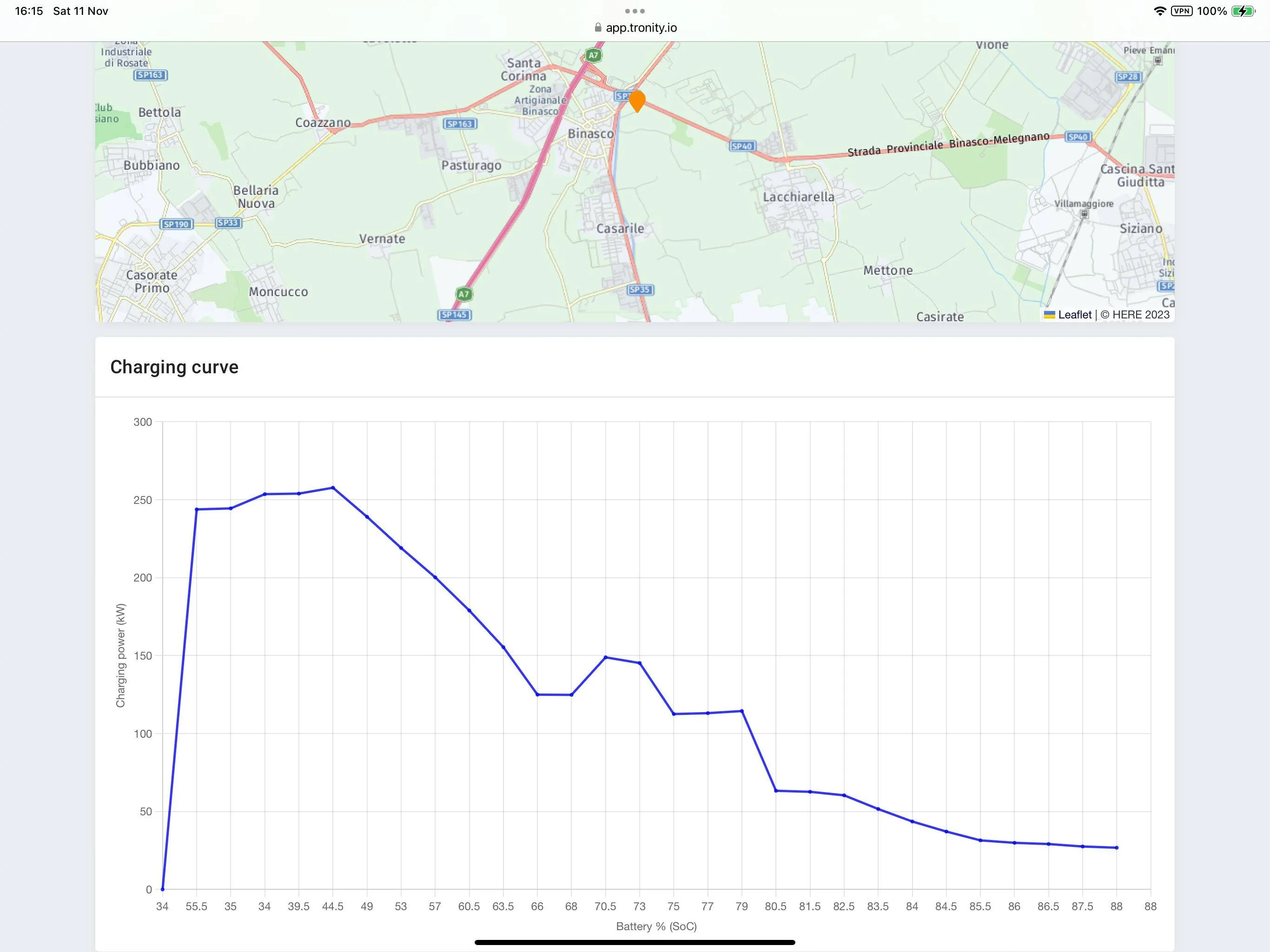

It also documented the charging stops, times, places, kWh added, charging speeds and cost estimates. And all this without any manual input at all! Slightly off with charges if you cross into different countries and currency, but it gives the basic kWh reasonably accurate. And it does not matter if you charge at Ionity, Tesla, other networks not in Porsche Charging. Or if you charge at AC or DC, hotel, restaurant etc etc. Very useful and can be recommended if you fancy a lot of statistics.

How did you do in Tronity to have a cost per Ionity, home and tesla?
You didn't have to do anything?
I have added some charging rates for Ionity, Porsche, Shell New motion and Tesla but it never shows me any of those data and cost.
Unless I have to tag each charging stops which I'm not going to bother.
And on app, when you are parked, what is the range displayed by Tronity?
For me it's 279km and never changes.
I wonder if it's the max km that I did once.
3,090
2,690
I think you get a 30 days trial period FoC and that was when I entered some basic information. I got several trial periods since there were issues with my cars connectivity.
I entered the rates via the web log in. I believe I could have entered the different rates for different countries as well but did not bother.
I have entered the Tesla rate and my home rate in the app. I guess I also need to enter rates for other networks in the Porsche Charging Service but have not done so yet.?? I try to avoid these with the per minute charge as much as possible. Irritates me when the charging stations does not deliver the advertised kW power and you get longer minute rates. Not a cost issue since it is small amounts,, but a nuisance. And I also entered the cost for me after 3 years for the PCS! It then spreads that out per month.
The app is not perfect as yet but getting much better. Tronity have been very helpful in trying to help out with a lot of Porsche Connectivity issues and they are not all solved as yet.
