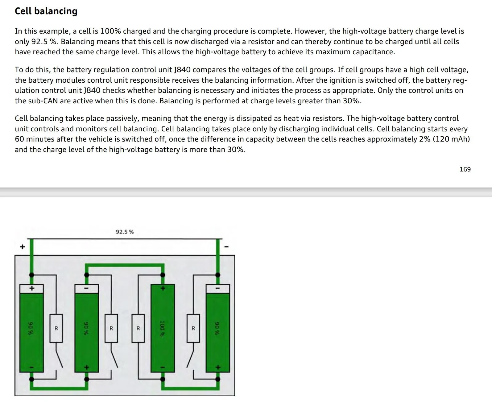

Audi Etron GT ( brother of the Taycan) balancing process
Source: @rs38 https://static.nhtsa.gov/odi/tsbs/2021/MC-10190946-0001.pdf

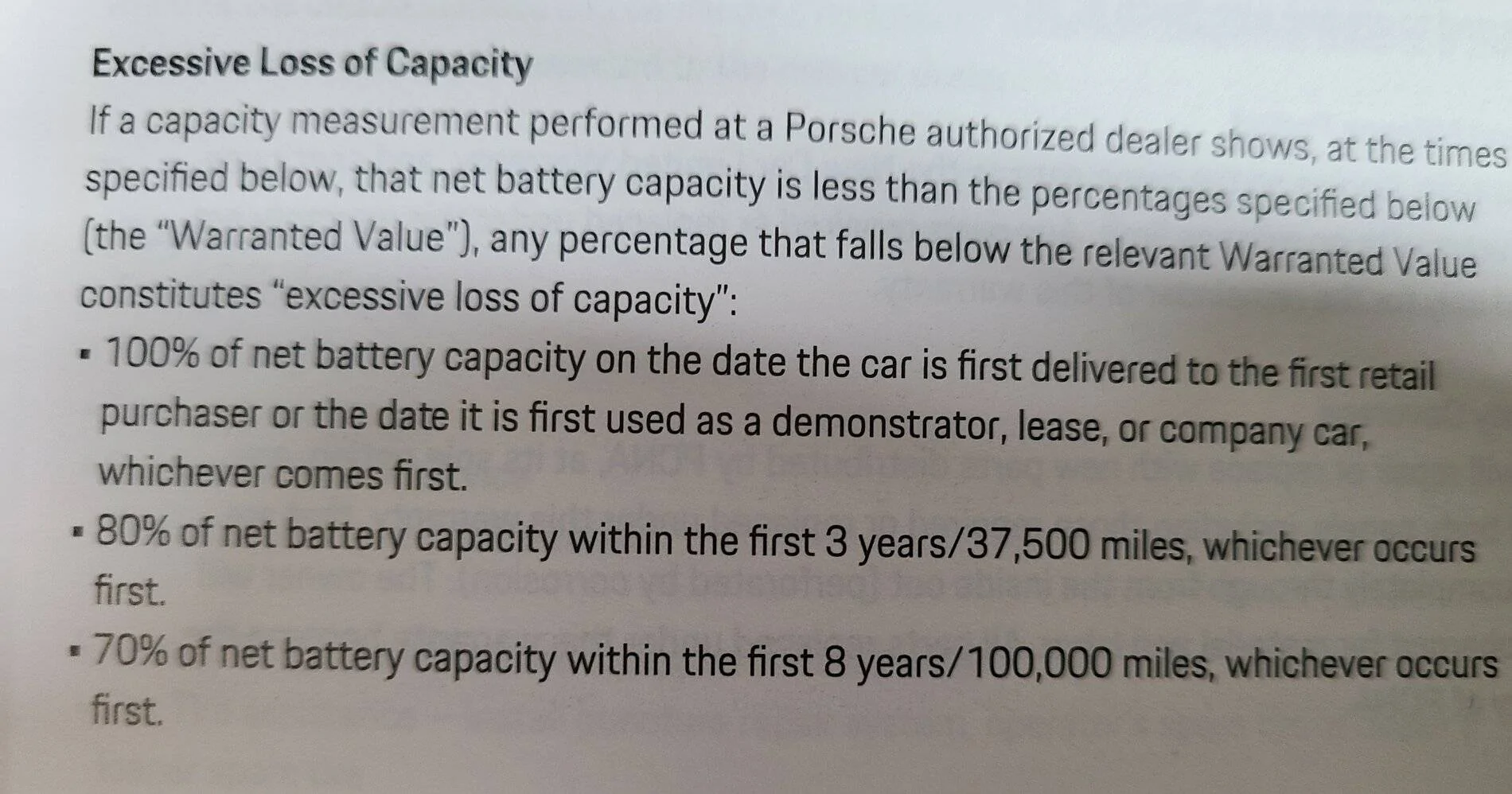

How can any ‘loss of capacity’ be measured? Would it be obvious, i.e the charging display no longer gets to 100%? If so, has anyone experienced this yet?
160
5,811
8,649
I do not believe the display will ever not show 100% - but overall range can drop - if you notice less range - the battery can be measured by the dealer for it's current "true net" capacity - if it's lower than 80/70% vs. factory spec then warranty issues are on the table and would be discussed I'm sure.
it's always at Porsche's discretion as to how the warranty issue is "resolved" - and do not assume you'll get an entire battery replacement (but you might). Also you may not get "back" to 100% factory spec - they have the option to only service the battery to restore it to meeting warranty condtions - i.e. you're at 63% capacity with in 3 years - they could only service the battery enough to restore/repair/replace modules to get back to 82% - and that would meet warranty criteria.

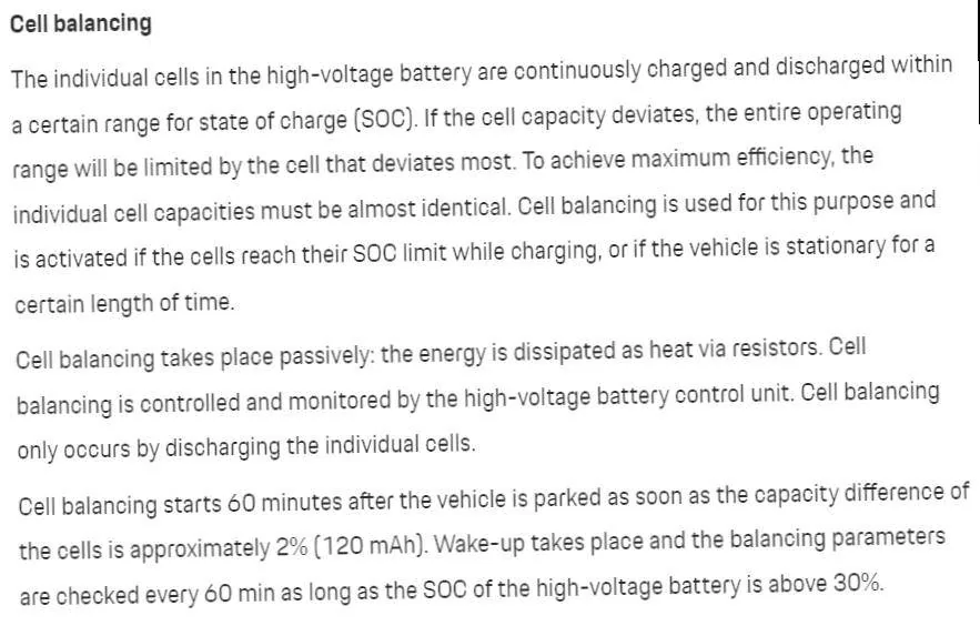

That's an excellent find from the Audi docs! Thanks for sharing!
And frankly it's disappointing news.
It looks like the Audi/Taycan balancing is "passive" and "resistive" which means old-school technology and inefficient operation compared to active capacitative or active dc/dc balancing. And it says that it'll balance from 30% charge which I know from experience is good only for "gross" balancing and not fine balancing. And in the same doc it says that the maximum balancing current is 100 milliamps which is shockingly low. It could take days or weeks to remedy a signifcantly out of balance battery. Frankly I would expect better from the Porsche/Audi engineers.
By way of comparison, I have a self-built 14KW Lithium battery in my boat, with an active capacatative balancer that has a 4,000ma maximum balance current, starts balacing at around 90% charge, and keeps the cells within 0.001 volts indicated and 0.002 volts actual. It took over a day to get the battery initially balanced, and then maybe an hour per week keeping it that way. The Taycan, with its 100ma max probably takes days to get into gross balance and achieves fine balance probably never.
The very simplistic balancing scheme makes the extra unused battery capacity (93.4kwh gross, 83.7kwh usable) absolutely necessary.
Oh and a brief bit of Googling says (second hand info though) that Tesla also uses passive capacatative balancing, but starts balancing at 93% state of charge.

as far as I know, every(!) volume OEM is doing "only" passive balancing.
monitoring cell voltages with Carscanner App I regulary see deviations of all 198 2p cells at ~ 0.005V, which seems to be a good industry standard.
What do you think is wrong with balancing cells starting at 30% SoC or more?
