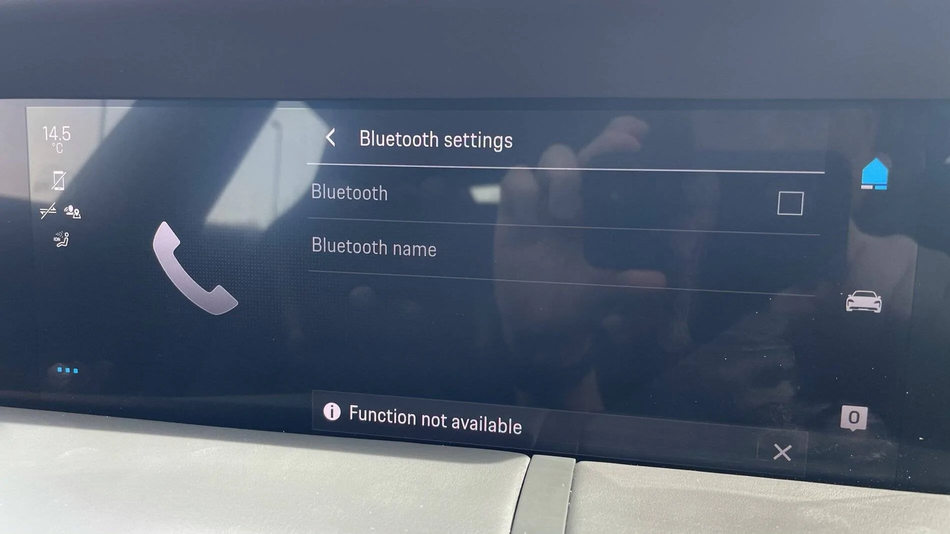

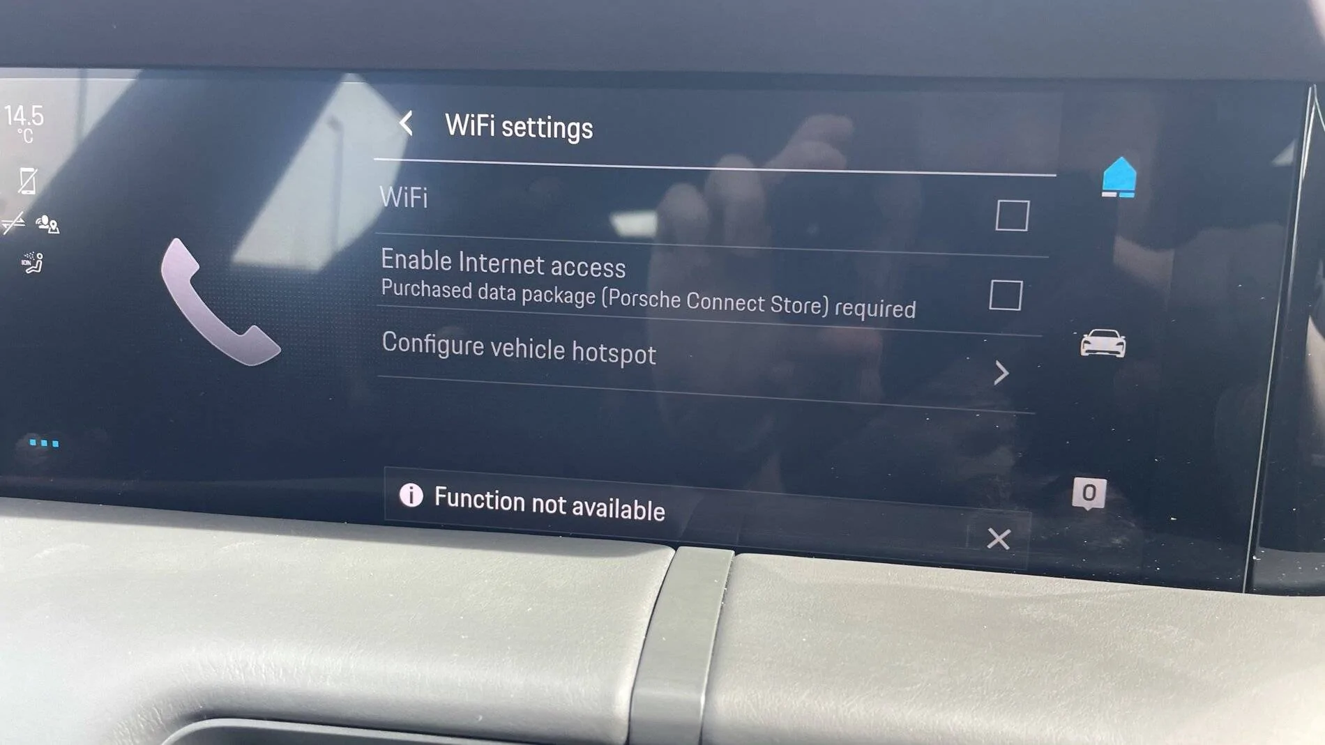

Neither my Wifi/Bluetooth function (randomly) are not available. Usually rebooting the PCM (via engineering mode) works, but that hasn't helped today and I rebooted a few times.
This has also resulted in CarPlay (wired in using USB) also refusing to load.
Its not very clear from the pics here but both the Wifi and Bluetooth option are greyed out and if you attempt to tick the box you get the "Function not available".
Anybody get this?

Just realised there is more impacted:
  • Bluetooth & Wifi options disabled.
  • Phone won't connect to PCM.
  • CarPlay both wired and wireless fails to start.
  • Porsche Connect website and app shows "out of date" data – suggesting car isn't sending latest data.
  • Apple Music/Podcasts service not available.
  • Intermittent reporting of the SOS Emergency Phone not available and the light on the roof turning red.
  • Weather service disabled.
Is this looking like OTA Communications Module failure ?
