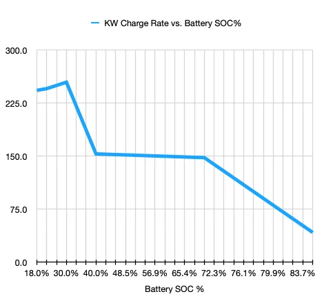

here is a graph of a charge session w/EA this past summer in Paso Robles
Porsche Taycan Won't charge at 350 Screen Shot 2021-02-01 at 9.03.52 AM
after about 35% SOC the charge rate starts to drop from it's peak of 254 kW - now was this because of the vehicle or the charger? i.e. did the charger run out of "juice" and could no longer provide that level of charge? or did the car start to ramp down the charge rate for some set of factors that we don't know about?
the point is by time the battery was at 40% SOC - I was only getting 150 kW - but that rate stayed consistent until about 70% SOC at which point it started ramping down as the battery got closer to full...
however 150 kW flat-line charge rate from 40% to 70% SOC is world class and way better than any Tesla I've ever owned. All other EV's have slower charge rates, so the only EV that comes close to the Taycan is the Tesla Model 3/Y products - and they based on my experience can not sustain a 150 kW deep into the 70% SOC range…

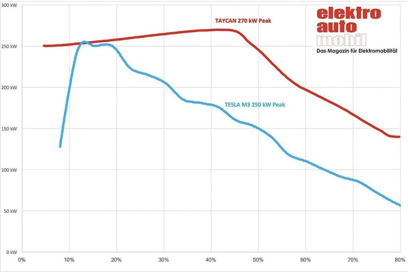

posted below is the "ideal" Taycan charge rate w/taper - the red line pretty much represents the best case scenario for a Taycan…in real world conditions you'd be hard pressed to do better, and it's very likely you'll rarely achieve "the red line"…the Tesla M3 is also on this chart - my intention is _NOT_ to start a comparison - it's simply the best chart I've found for the Taycan so we'll go with it
even under _IDEAL_ circumstances the Taycan will start to taper the charge rate @ about 45% SOC but doesn't drop below 150 kW until after 75% SOC…my personal experience is it remains above 100 kW until about 90% - at which point I'm unplugging and driving to the next fast charger or my destination because that next 10% of SOC will take forever on the charger.

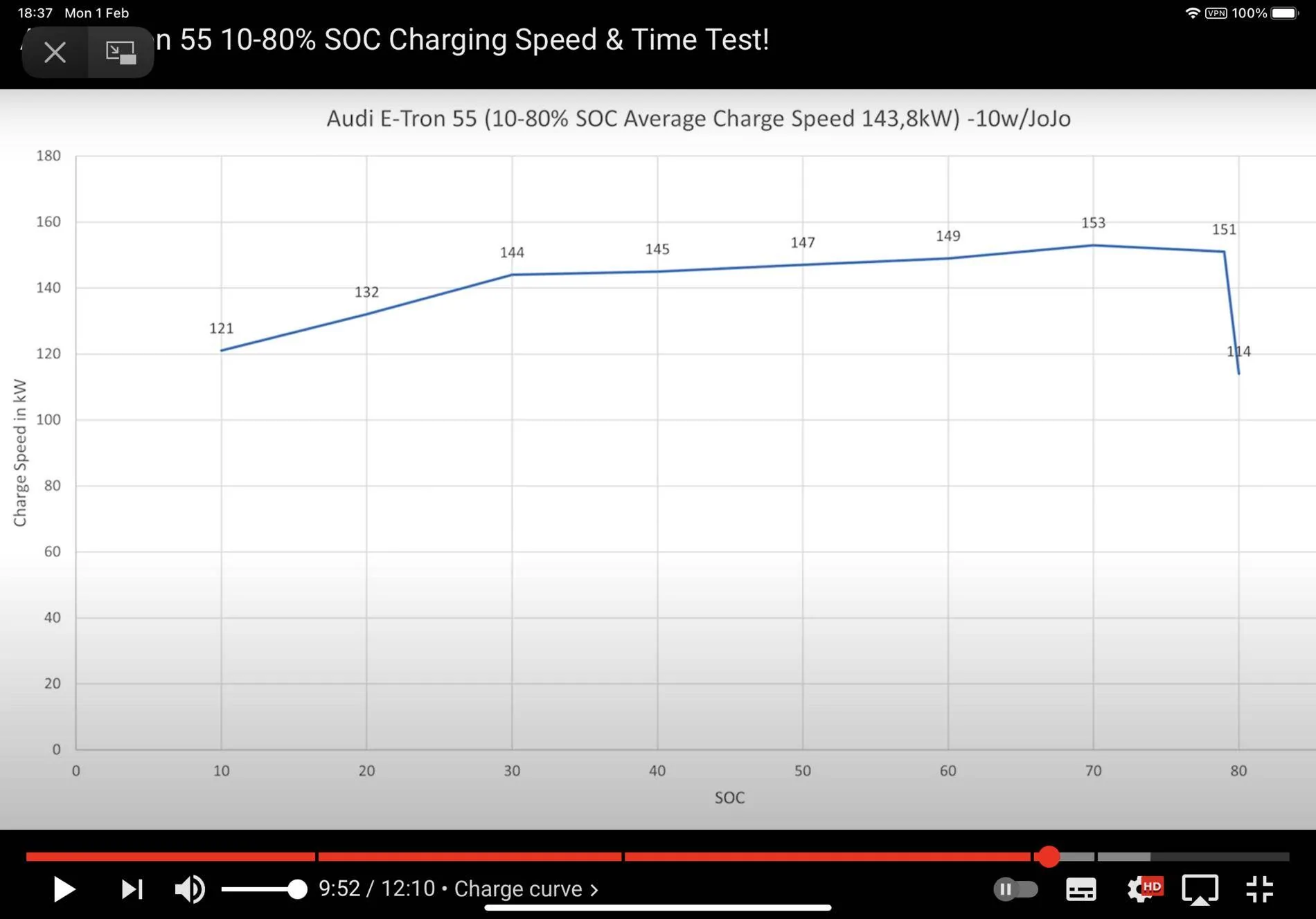

The only other car I know of that has a good charge curve is the Audi e-tron. Here is a screen shot of its charge. NB the Audi has a max rate of 150 kW, but the 10 - 80 % charge time is quite fast. Average has been calculated to 143.8 kW!
Porsche Taycan Won't charge at 350 74C08528-2D43-44DC-B9E6-6605526579E9
