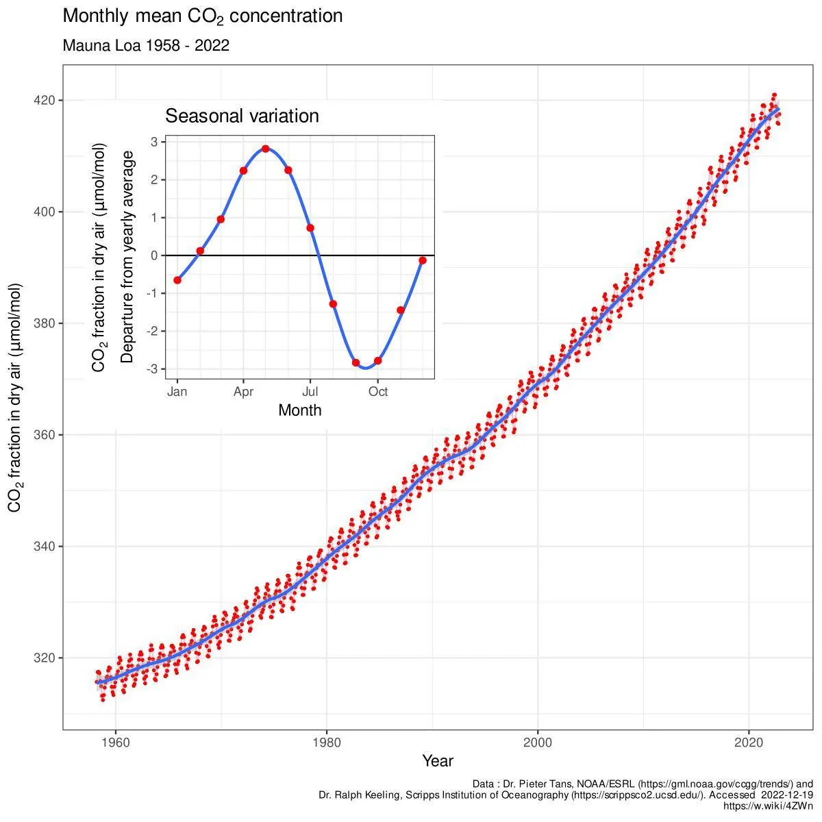

“The only true wisdom is in knowing you know nothing” (Socrates)… but data like the below does not give me much optimism.
Porsche Taycan [Article] = as I've always said don't sweat the battery lifespan -- "Researchers make surprising discovery about lifespan of EV batteries" IMG_6169
