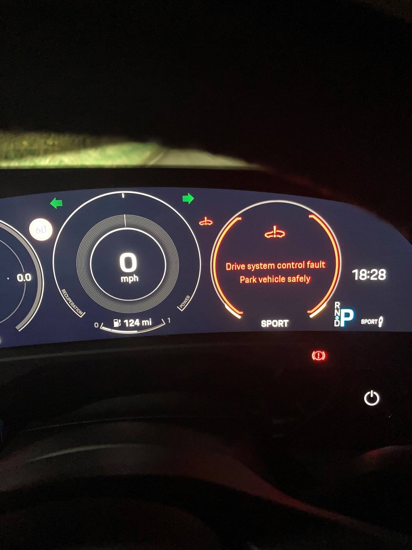

Same thing happened again last night (the day after it happened the first time). Have booked it in with a dealer
Yes that's exactly the fault I had. It will be interesting to hear what your dealer says because all mine did was clear the fault and reset it. They said they had never heard of anyone experiencing this twice.
