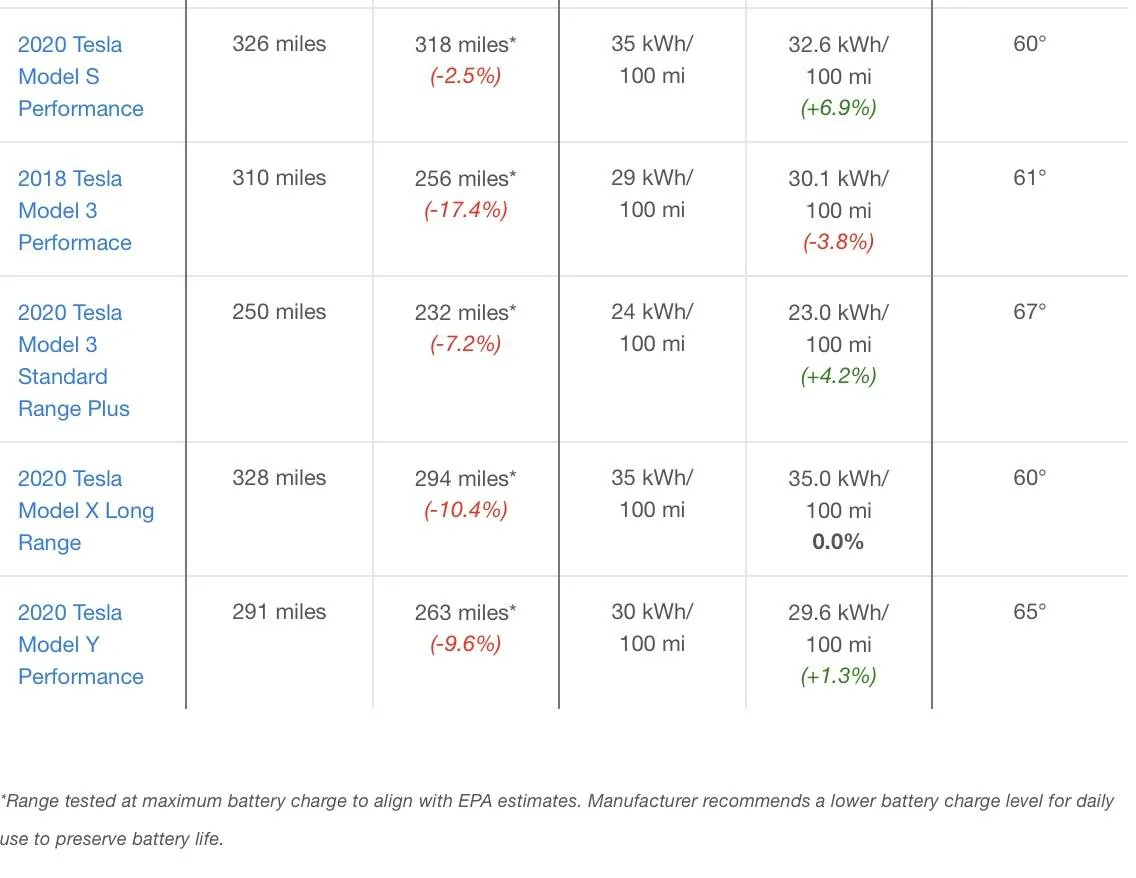

  • Every Tesla we've tested has failed to hit its EPA range estimate

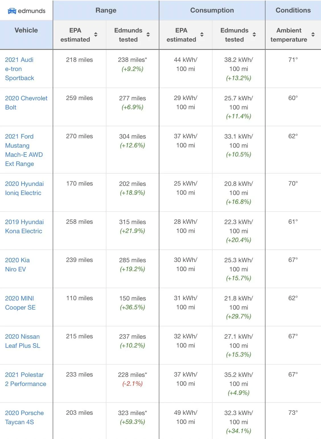

What is this chart showing me?
This chart shows an electric vehicle's official EPA range and energy consumption compared to the range and consumption results from Edmunds' own testing, which is designed to be a real-world complement to the EPA's laboratory-based process. If you see arrows in a column heading, click it to change the sort order.

Wow! 4S better mileage than the Model S. Should have been 123 miles worse and it was 5 miles better. The Tesla numbers weren't far off, but the Taycan EPA numbers were not even in the same ballpark as actual. Maybe Porsche should re-certify the cars...🤔

Hell, that 280 -290 sounds outstanding, especially compared to the real world numbers of Teslas Tested. They explain in the article how they got those numbers, but they also point out many factors can influence range and their numbers are no more accurate than EPA. Just to use a data point for consumers. I’m taking my Taycan on a road trip next month, so I’ll see what I get.

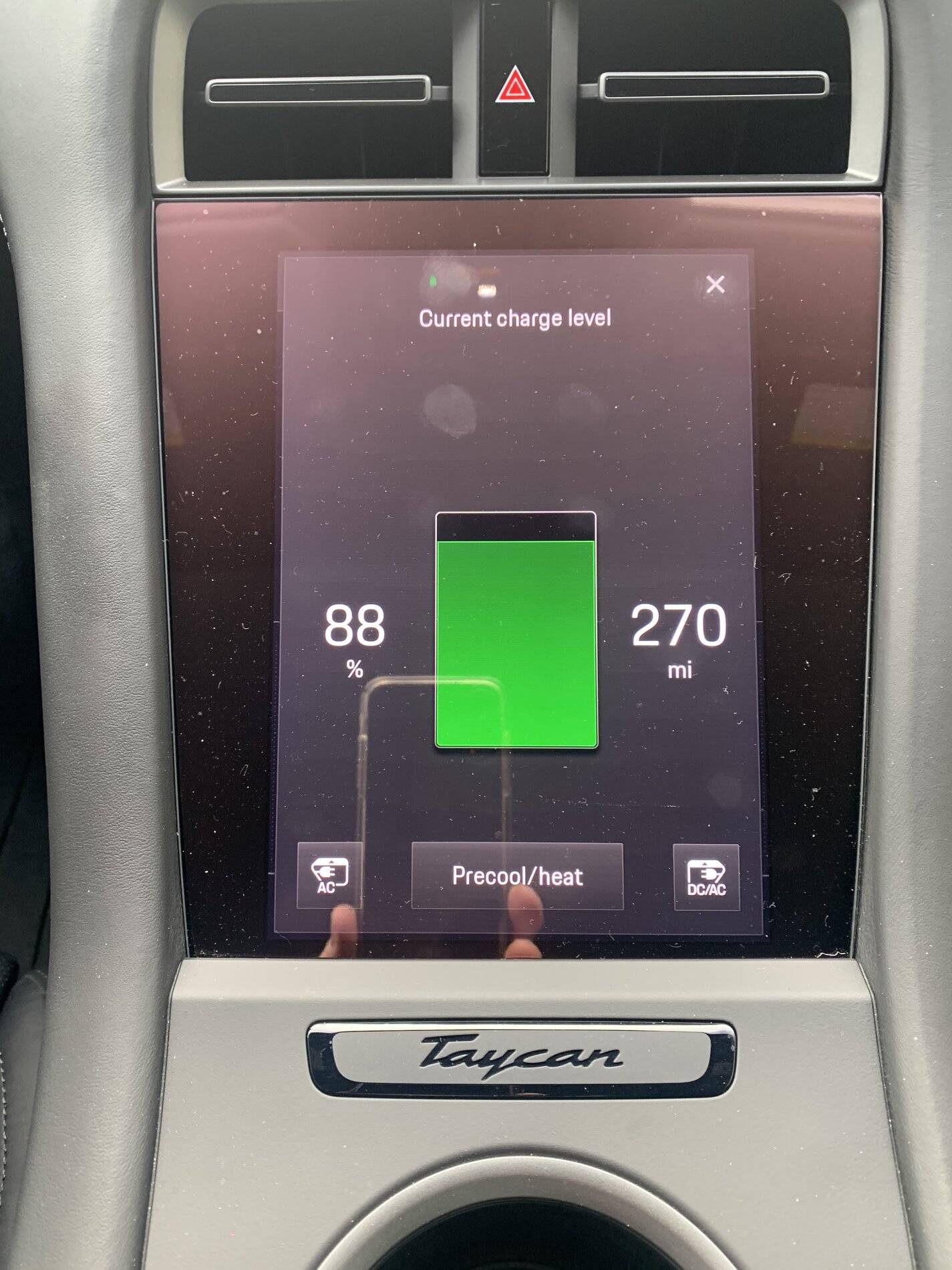

my California trip to Los Alamos and back strongly indicated that 270 miles is a easy easy gig for a Taycan Turbo…even with the Mission-E wheels…
https://www.taycanforum.com/forum/t...-ca-to-los-alamos-ca-to-aptos-ca-w-data.2659/
…The Drive to Bob's well bread used 72% SOC (arriving at 28% SOC) with 78 miles "left" on the range meter in the center of the dash display. This places the Taycan firmly in the 280 mile range category - and strangely enough the exact distance was 201.9 miles - which is the Taycan's EPA rating. We we drove the EPA distance and arrived with 28% battery left over. …
this data is very consistent with the Edmunds results - 300 miles is a stretch goal - but 270 is in line with distance I often achieved with my Model S P85D
closer to 300 is doable with: 4S, and non-Mission-E wheels - better speed limit discipline.

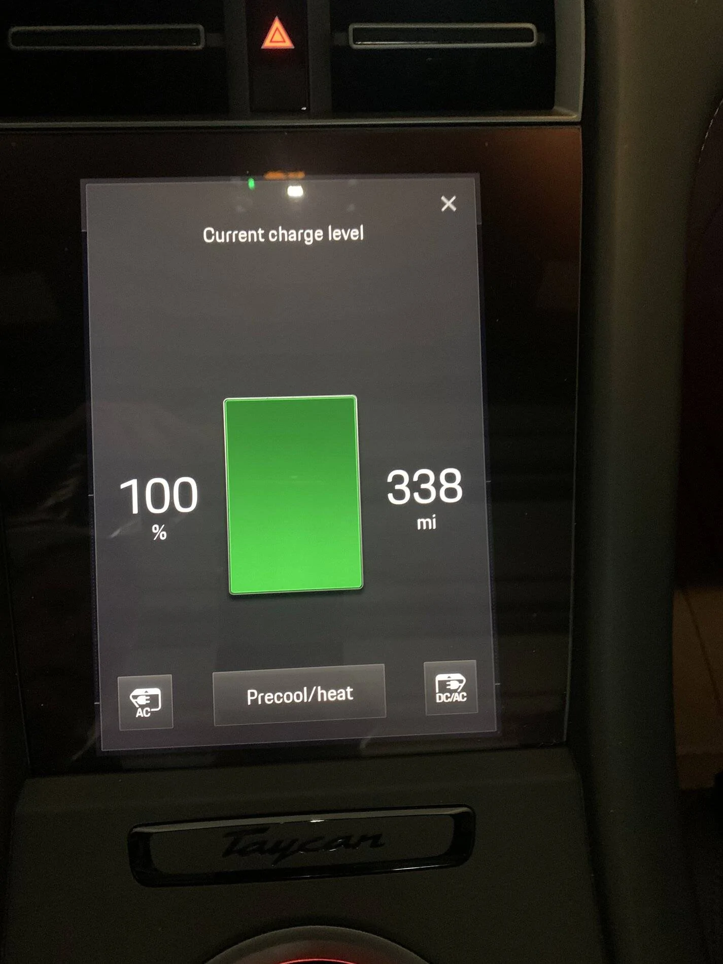

Anyone getting over 300 miles per “tank” as this suggests? My 4S is on order and I would LOVE to get that kind of range !
Last fall with warmer temps I saw 300 to 338 range at 10C to 15C.
(Actual range will vary or be lower depending on driving mode selected and actual speeds driving.)
With snow and colder temps seeing 258-265 miles @ 85% SoC and 282-289 miles at 100% SoC from 0C to -5C on Pirelli PZero Elect 20in snow tires. Both fall and winter numbers are with these tires.
MY20 4S+
Images are from early December 2020.
Hope this helps.

As mentioned, 32.3/100 kWh is only about 265 miles and normal consumption for a 75+ mph highway drive in summer.
Oh. Wait. LOL. Edmunds got 32.3kWh/100 miles.. and "323" range. Anyone else see the problem? My guess is they did a shorter test and attempted to math out the range based on the consumption number they saw, but instead of dividing against the battery capacity (approx 86 kWh usable) they divided against 100.
It's either a typo or someone at Edmunds tried to take a shortcut.
